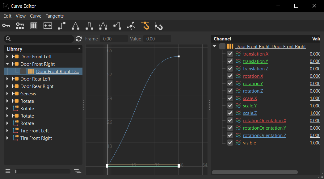

    When a node is selected in the Library to the left, its animated channels are listed to the right.

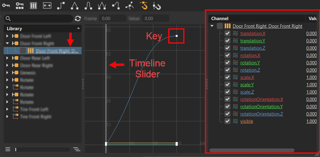

  3. Drag the vertical line in the Curve Editor to select the moment when you want the object to reach a certain position.
    If it helps, open the Timeline (Animation > Timeline) for more accurate frame navigation.
  4. Select an object or a channel.
  5. Select Key All Channels Key All Channels or Key Selected Channels Key Selected Channels to set a key for the selected channels.
    Tip:
    Press F to scale and center curves to fit the view.
  6. Drag the vertical slider (or Timeline slider) to select a different frame, then re-key the selected properties for that frame.

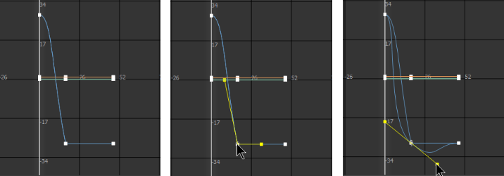

How to Edit an Animation Curve
  1. In the Curve Editor, click the node you want to change.
  2. Drag the key to change its frame position or drag the yellow curve handles to edit the curvature (tangent) between two keys.

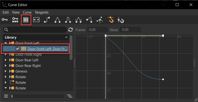

  1. Once something has been animated, if the Curve Editor isn't open, click Curves icon (the Curves icon) in the Quick Access toolbar to open it.
  2. In the Curve Editor, select an element from the Library, then click Create an animation block element (Create an animation block element). This adds a block element to the Curve Editor Library.

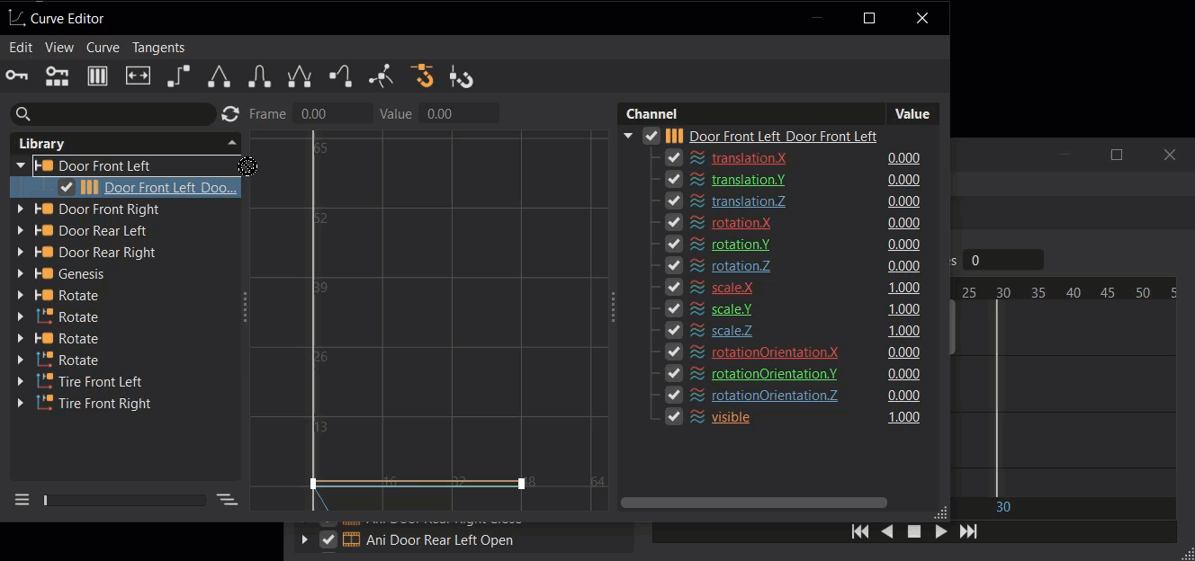

  1. Select Animation > Clip Maker to open the Clip Maker.
  2. Click Create and select Clip to create a clip.
  3. From the Curve Editor, drag the block onto the new clip in the Clip Maker to add the block to a clip. Expand the clip to see the block. A clip appears in the Clip Maker timeline to the right.
