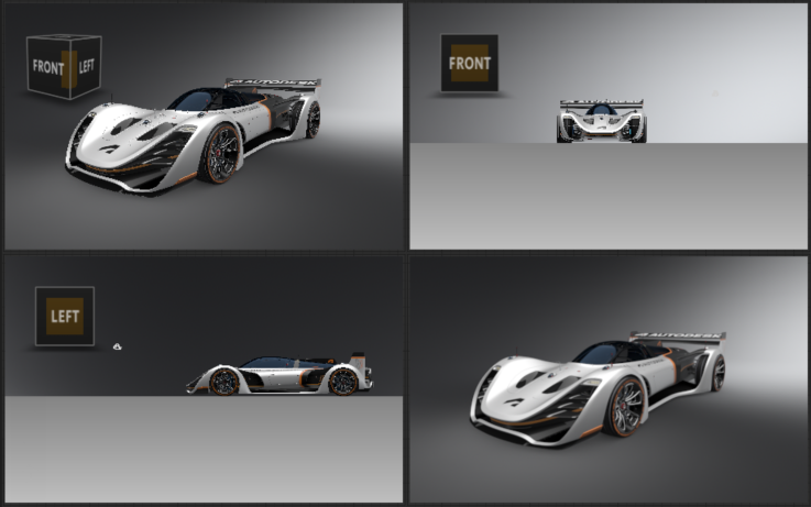

How to Split the View and Return to a Single View
Splits the Viewport into perspective, front, side, and top views.
| Show Single View | Toggle Split View |
To split the view, in the Menu Bar, select Window > Toggle Split View.
To return to a single display view, in the Menu Bar, click Window > Show Single View to display single view. The last active window, indicated by a white border, will become the single view.
For a shortcut to toggle between split view and single view, use Ctrl + Spacebar.

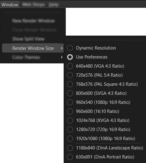

How to Specify the Render Window Size
Video captions: To adjust your render window size settings, please open the Window menu. The default value, Dynamic Resolution, indicates that your render window size depends on your user interface layout and your scene resolution.

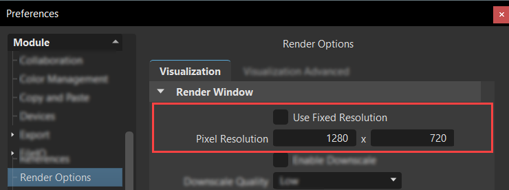

To set your window size to a fixed resolution, choose from different presets. Now your render window remains independent of your GUI modules.
To customize your fixed resolution, open the preferences and adjust the size in Render Options.
To specify the size of your render window, click Window > Render Window Size, then select from the options available.
Please note that when Render Window Size is set to Use Preferences, it uses the settings from the Edit > Preferences > Rendering > Render Window > Visualization tab > Use Fixed Resolution and Pixel Resolution options.
To set a default Render Window size, use the Render Options Visualization preferences.

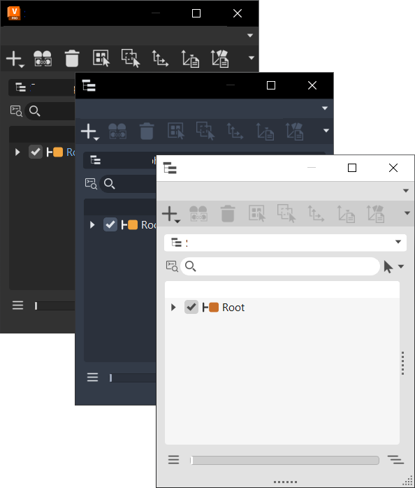

How to Change the Color Theme
To change the color theme used for VRED, click Window > Color Themes and choose one of the theme colors.
Since VRED uses colors throughout the UI to help to indicate states or differentiate one field from another, you will notice slight variations in color.

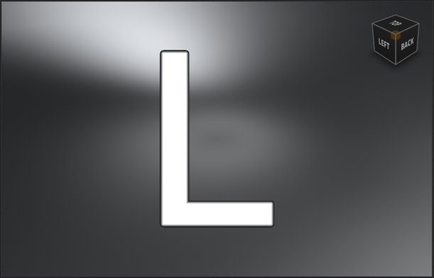

How to Identify Stereo Output Channels
In the Menu Bar, select View > Stereo Identification. A letter appears in the Viewport.
