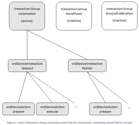

The Python API for VR follows the concept of connecting device actions, such as button presses, to actual functionality implemented through a Python script. The API is platform agnostic, which means scripts need to be written only once for different VR controllers. The only exceptions are buttons on the input devices. One device might offer different buttons from another. Therefore, this is something to keep in mind when using the corresponding interfaces in a Python script.
Functionality in VR, such as teleport, is called a device interaction in VRED and is of type vrdDeviceInteraction. These interactions contain several device actions of type vrdDeviceAction that reflect such things as button presses. In the case of teleport, there is one device action for activating the targeting arc, another for executing the teleportation, and one more for deactivating the targeting arc.
Figure 1 - Active interaction group containing several device interactions, containing several device interactions
In VRED, there is also the concept of interaction groups. Each device interaction is part of an interaction group and there is only one group active at a time. When such a group is active, all its included interactions are also active and vice versa. Different groups are a convenient way to change the context of user interactions quickly, like when a different tool is selected in VR. It is important to know that every device action, such as pressing button A of the left controller, can only occur once in an interaction group. This prevents triggering multiple functions at once, which prevents side effects between different interactions.
For better understanding the relationship between interaction groups, device interactions, and device actions see Figure 1.
The API also gives access to objects of type vrdVRDevice representing the input devices. These objects provide some additional functionality to read and manage the state of each device.

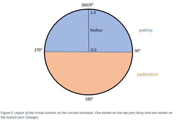

Setting Virtual Buttons on Touchpads
Some controllers, like the ones of the HTC Vive, have touchpads that can be split into different areas to simulate more buttons. The class vrdVRDevice provides the method addVirtualButton, which takes two arguments, one object of type vrdVirtualTouchpadButton and a string for the corresponding non-virtual button it belongs to.
padTop = vrdVirtualTouchpadButton("padtop", 0.0, 1.0, 270.0, 90.0)
padBottom = vrdVirtualTouchpadButton("padbottom", 0.0, 1.0, 90.0, 270.0)
This example starts with creating two vrdVirtualTouchpadButton objects. The first argument of the constructor takes a name for the new button, the second and third argument describe the radius where the button is located, in this case it uses the full radius of the touchpad. The fourth and fifth argument describe the angle on the touchpad where the button is located. In these two cases, the first button will cover the top half and the second, the bottom half, of the touchpad. Figure 2 illustrates the layout of the two buttons. Note that in case of overlapping buttons, only one of the buttons will send a signal. It is recommended to not create overlapping buttons.
Figure 2: Layout of the virual bottons on the circular touchpade. One botton on the top part (blue) and one botton on the bottom part (orange).
After the instantiation of the virtual buttons, they are added to the controller.
controller.addVirtualButton(self.padTop, "Touchpad")
controller.addVirtualButton(self.padBottom, "Touchpad")
The method vrdVRDevice.addVirtualButton takes two arguments, the first is the vrdVirtualTouchpadButton object and the second is the name of the actual button on which the virtual button is placed. In VRED, this currently works only for the round touchpad of the HTC Vive controller.
The newly added virtual buttons can now be used like regular buttons, when creating device actions.
myAction = myInteraction.createControllerAction("left-padtop-pressed")
See the script vr/virtualControllerButtons.py or vr/groupTeleport for more examples on how to use virtual buttons.
