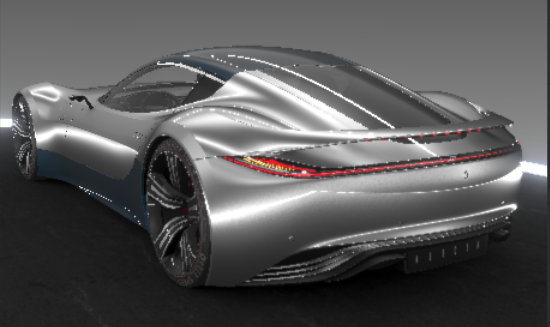

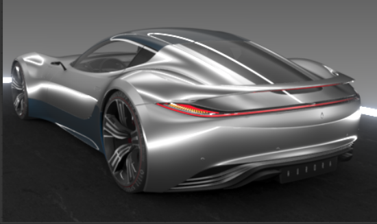

How to Use Realtime Antialiasing
Antialiasing is a smoothing calculation that builds up the look of surfaces, materials, and textures. Use anti-aliasing options to give surfaces a more realistic appearance, but be aware that frame rate might be affected.
Antialiasing off Antialiasing on
Aliased Antialiased
Computer screens are made of small square pixels. This is why an illustration of round objects or curved surfaces appears faceted at its edges. Antialiasing makes the edges of rendered objects less pixelated.
When activated, the calculation starts once the camera position has not changed for more than a second. (This is the Preferences > Render Options > Render Window > Still Frame AA default setting.) The progress is shown in a clockwise growing circle around the mouse pointer. If the circle is complete and closed, the calculation is finished.
