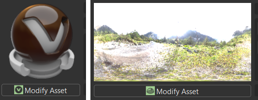

Assets are externally-referenced files from preset libraries found in the Asset Manager. They can be shared across multiple projects and can be materials, geometries, environments, and sceneplates. After import from the Asset Manager, material and environment representation from referenced assets gets an additional green icon in the lower left corner.
Asset material and environment

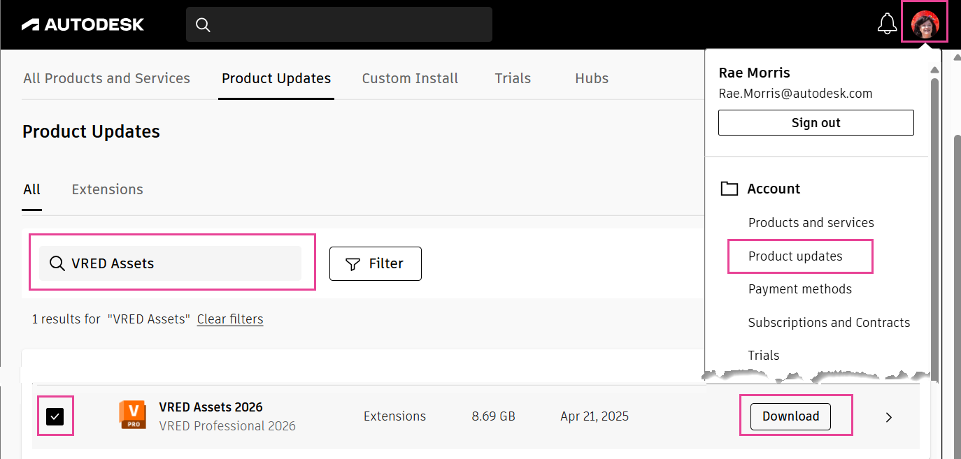

  1. To go Autodesk.com, click the Sign In button, and sign in.
  2. Click your user icon, then in the My Account section, select Account > Product updates.
  3. Type, VRED Assets, in the search.
  4. Check the box next to the VREDAssets version you want, then click Download.
    Product Updates and VRED Assets

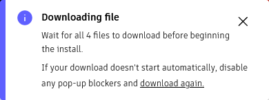

    Important:
    There may be multiple files to download. Ensure your browser pop-up blocker is disabled. If you see many downloads, this indicates pop-ups are still blocked. Click it, select the Always allow... option, and click Done. Multiple downloads should begin.

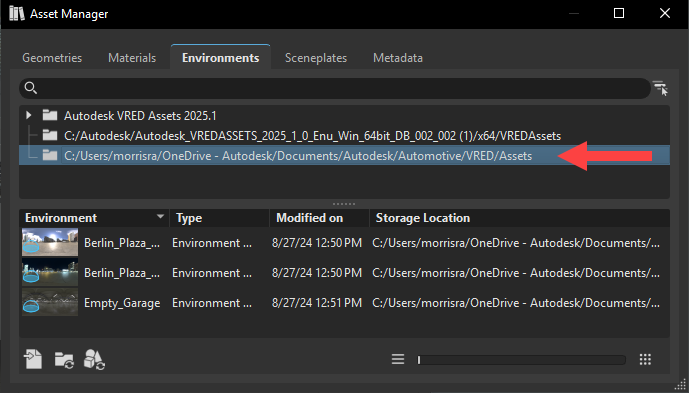

Adding an Asset Location
Through the preferences, you can add additional assets folders to the Asset Manager.
  1. In VRED, select Edit > Preferences > Scene > Asset Manager, and in the Search Paths section.
  2. Click a tab along the top to add the folder to a specific Asset Manager tab. For example, for a material, select the Material Paths tab, followed by clicking Add a Path icon Add a Path.
  3. Locate the folder, then click Select Folder to add the folder to the selected tab.
  4. When finished, click Apply and Save. This closes the preferences.
  5. In the Asset Manager, click the folder from the list, then click Import.
  6. Locate the asset's .osb file, then click Open to add it to the Asset Manger.

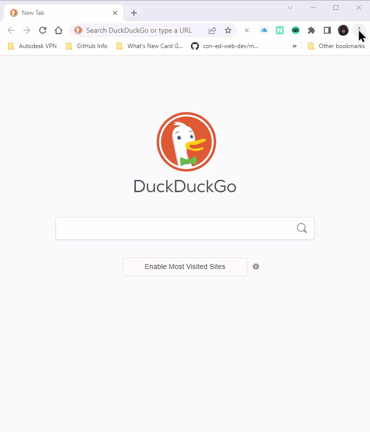

Chrome Troubleshooting
If Chrome is preventing you from installing the VRED Assets, follow these steps for changing your browser privacy settings.
  1. Select the setting icon in the browser.
  2. Select Settings and type Site Settings in the search field.
  3. Click Site Settings and scroll down to Pop-ups and use redirects.
  4. Ensure Site can send pop-ups and redirect is enabled.
  5. Under Customized behaviors and next to Allowed to send pop-ups and use redirects, and click Add.
  6. Enter https://manage.autodesk.com and click Add.

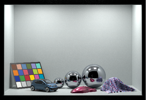

X-Rite SprectraLight QC
Find the X-Rite SpectraLight QC environment in the Asset Manager's Environment tab. Use this box environment to represent the D65 daylight lighting behavior of the real world device.
The following example illustrates how these random items are effected by the X-Rite SpectraLight QC environment.
X-Rite SpectraLight QC real world device
We measured the light source and side wall materials of the real light booth and created an HDR image from inside the original CAD model. This environment has a size of 950mm x 660mm x 595mm and is ideal to evaluate product designs and material examples under real lighting conditions.
How to Add a Network Asset Library and Access The Assets
Use the Asset Manager preferences to add a network asset library to the Asset Manager. This enables you to access assets on the network through the Asset Manager.
  1. Select Edit > Preferences > Asset Manager.
  2. In the Search Paths section, click Add Path.
    Adding a path
  3. Navigate to the Network Asset Library and click Select Folder.
  4. Click Apply to add its path to the Asset Manager and OK to close the preferences.
    Added Network Asset Library
    Note:
    To change the path of a library for a new project, use Change Path. To remove a path to a no longer accessed library, use Remove Path.
  5. Open the Asset Manager, click the network folder from the list, then click Import.

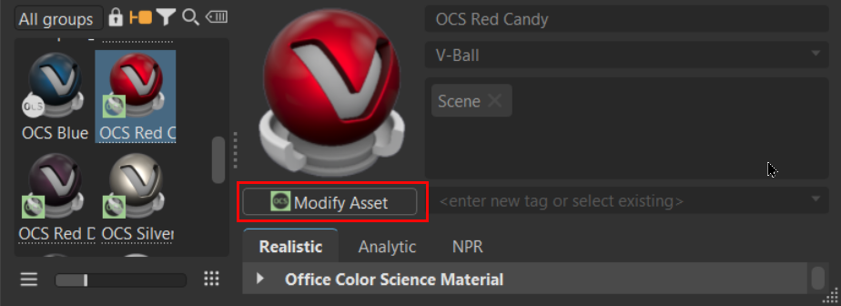

Modifying and Saving an Asset
Because assets are externally-referenced files, you must use Modify Asset to modify them. Once modified, the changes need to be saved, using Save Asset.
  1. In the Material Preview, select an asset to load it into the Properties Editor.
    Properties Editor uneditable
  2. Right-click the asset and select Asset > Modify. The asset properties are now editable.
    Tip:
    You can also click the Modify Asset button.
    Properties Editor editable
  3. Modify the material asset.

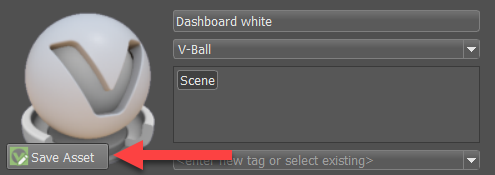

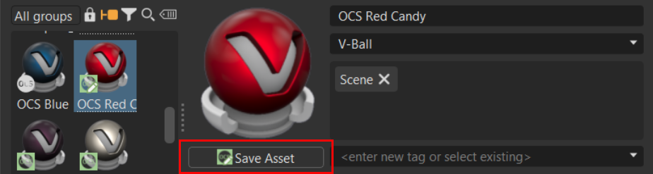

  4. Click the Save Asset button to save the modifications to the Asset Manager.
    Save Asset button
