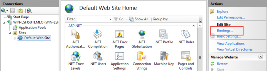

Start Internet Information Services, if it is not already running.
Expand the Sites tree and select the website that is hosting the AutodeskDM Virtual Directory. In the image below, the website is Default Web Site. Select Default Web Site and click Bindings from the Actions pane.
Remove https binding.

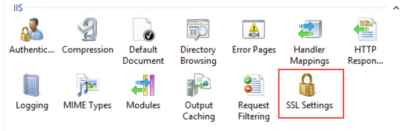

Select the AutodeskDM > Services virtual directory and double-click the SSL Settings button.
In the SSL Settings page, uncheck the Require SSL option.
Click Apply from the Actions pane.
