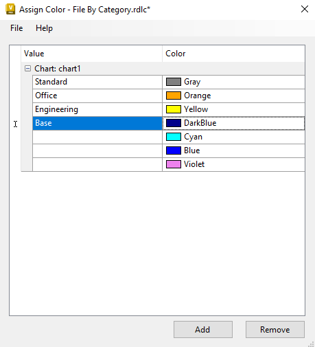

When a report is generated that returns a value for which a color has not yet been assigned, the report control will assign a color to the new value from a predetermined list of colors and write back the report template a name and value pair for the new color. The new value and default color assignment are displayed in the Assign Color dialog where the administrator can update the template by assigning a color to this new value.
When a template is opened in the Assign Color dialog, the chart elements contained in the template are listed along with the currently assigned color for each element. If the template contains more than one chart, the chart elements are grouped by chart.
Templates can be opened from a local folder or from the vault. The Value column will be populated with the names of chart elements only if a report has already been generated. If no report has been generated ,the fields in the Value column are blank.
By default, the Assign Color dialog displays a default palette of eight colors. Unless specified in the template, the colors are assigned to chart elements in this order:
Enter the exact chart element name in the Value field and then select a color to assign that color to the chart element.

Click Define under Report Management to open the Assign Color dialog.
On the File menu, open a report template from either the vault or a local folder.
If the template does not contain any custom color properties, the default color palette is displayed.
If the custom color properties have already been added to the template, the value names are extracted and displayed with their assigned color on the dialog. Any new values without an assigned color are displayed with the next available color in the default list.
Specify a new color assignment for an existing property by selecting a new color in the Color field.
