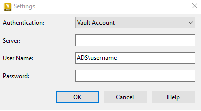

On the workstation where you want jobs to be processed, go to the Windows® Start menu and select Autodesk Data Management ► Autodesk Job Processor [edition] for Vault to launch the Job Processor application.
Select Administration ► Settings to display the Settings dialog.
Select the appropriate Authentication method:
Vault Account: Requires a Vault-specific user name with a password.
Windows Account: Uses Windows Active Directory credentials, which are entered for you.
Autodesk ID: Uses Autodesk ID credentials.
Specify the server from which you want the job processor to pull jobs for processing.
Enter the User Name and Password of the user for this workstation. If you are using Windows Active Directory, this information is entered for you automatically.
If you select Autodesk ID, you will need to sign-in to your Autodesk account.
Click OK.
Select File > Resume to log in to the specified server.
