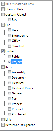

A UDP can also be associated with specific entity sub-classes. For example, a UDP can be created so that only Folders of type Project are able to use that UDP.

Folder | Use the folder association to create a custom folder property. The custom property may be restricted to a folder sub-class, such as a basic folder or project. |
