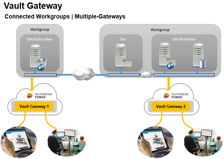

With Vault Gateway, members of your team can remotely connect to the vault.
Vault Gateway technology securely connects remote devices to Vault servers through a cloud service. The Vault Gateway service generates a URL used in place of the Vault server name when logging into the Vault client software (e.g.,-vault-client,-add-ins,-etc). The cloud service interfaces with the vault server, exchanging data between the client and server in real time.

Vault administrators manage their team's gateway in the ADMS Console. Administrators must verify that the requirements to use Vault Gateway are satisfied to configure a gateway.
Team members connect to a gateway when they log into the Vault Client.
