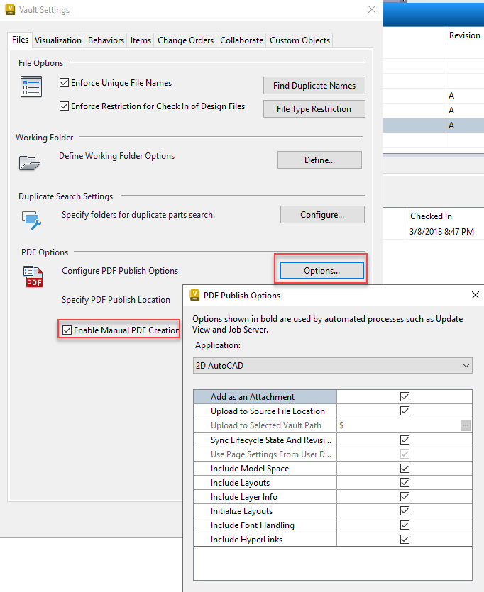

Configure PDF Publishing Options
Select the settings for 2D AutoCAD and 2D Inventor PDF printing.
Note: You must have administrative access to perform these tasks.
  1. Click Tools > Administration > Vault Settings.
  2. Under PDF Options, click the Options button to launch the PDF Options dialog and configure the PDF publishing settings.
  3. Select an application and check the desired settings.
Check the Enable Manual PDF Creation box to be able to create a PDF without going through lifecycle state change for a drawing file. The Create PDF command is available in the toolbar, context menu, and the Actions menu.
These tables describe the settings on the PDF Options dialog for 2D AutoCAD and 2D Inventor publishing.
2D AutoCAD PDF Publishing Options
Add As An AttachmentShows the published PDF file as an attachment to the file.
Upload to Source File LocationAutomatically stores the published PDF file to the selected file location.
Upload To Selected Vault PathDefines a specific location (using Browse) to store the published PDF file.
Sync Lifecycle State and Revision As SourceAllows both the published PDF and its source file to have the same lifecycle state and a revision value. States configured as 'Released' on the Control tab of the Lifecycle State dialog must match between the file and PDF lifecycle states.
Use Page Settings From User DWGEliminates the need to reconfigure page settings in Vault if previously done in the native application. Checked and cannot be unchecked.
Include Model SpaceEnables the published PDF file to contain the model space view.
Include LayoutsEnables the published PDF file to contain layout space views.
Include Layer InfoEnables the published PDF file to contain layer information.
Initialize LayoutsSupports legacy files.
Include Font HandlingEnables publishing a PDF file with font styles.
