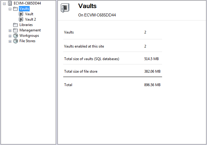

View a summary of vaults enabled at the selected site. You can view and manage specific vaults by clicking on them.
In the ADMS Console navigation pane, click Vaults.
A summary of the vault server statistics is displayed. The statistics include the:
number of vaults on the server
number of vaults enabled at this site
total amount of space used by the vaults
amount of space used by the file store
total amount of space used by the vault server
