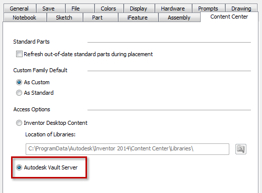

You can specify separate servers for Vault and Content Center by following these steps.
Inside the Inventor Application Options dialog, make sure that Inventor is configured to use Vault for Content Center Libraries.
