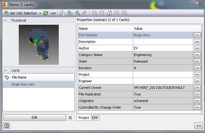

The Data Cards feature provides convenient summaries of the metadata assigned to a file or group of files through a single point of access. With data cards, you can determine a file's vault status, see a thumbnail of the file, and review and modify property information without leaving the Inventor application.
Whenever a part is selected on the CAD canvas or in the Model or Vault browser list, the part is highlighted on the canvas, in the list, and the data card automatically updates to show the relevant information for that part.
Note: If you select multiple parts in the browser list, the corresponding parts are selected on the CAD canvas but the data card is not updated. Refer to the topic on Working with Card Decks for more information on updating multiple data cards.
Similarly, if a data card is selected in a card deck, the part is selected on the CAD canvas and in the Model or Vault browser list.

Data cards can be displayed as an individual card or grouped together into a card deck for faster referencing of multiple files. Data cards also have two views: a fingertip view and a full data card view.
