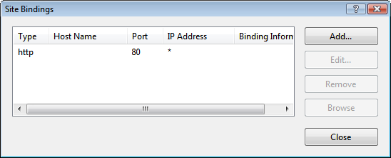

  3. In the Internet Information Services dialog box, expand local computer ►Sites and right click Default Website and select Bindings.
  4. Select the http setting and click Edit.
  5. Change the port number to 80 and click OK.

  5. Right-click Default Website and select Edit Bindings.
  6. Select the http setting and click Edit.
  7. Change the port number to 80 and click OK.
