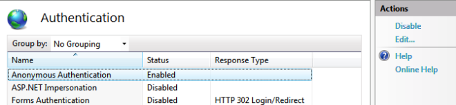

  3. Double-click Authentication.
  4. Click Anonymous Authentication and make sure it is enabled.
  5. Right-click on Authentication and select Edit to display the user name of the anonymous account used by iis. Verify that this account exists on the server.

  6. Double-click Authentication.
  7. Click Anonymous Authentication and make sure it is enabled.
  8. Click Edit to display the user name of the anonymous account used by iis. Verify that this account exists on the server.
