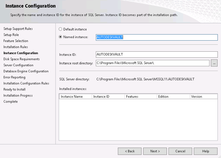

In the Instance Configuration window, select Named instance and enter the name. You can use "AutodeskVault", for example, or specify your own instance name.
Click Next.

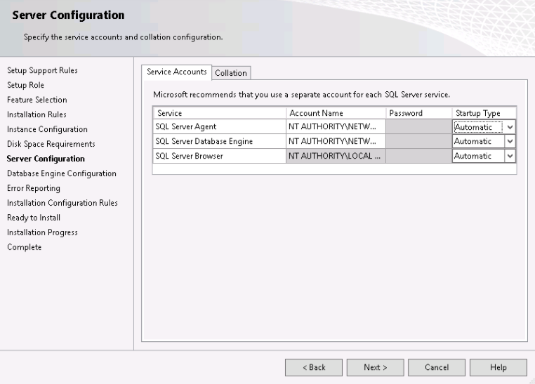

In the Server Configuration window, select the Service Accounts tab.
Specify the NT AUTHORITY\NETWORK SERVICE account for the SQL Server Database Engine. The local system account is also acceptable to use. If you plan to perform backups and restores to remote locations, specify a Domain User account. Set the Startup Type to Automatic.
Click Next.

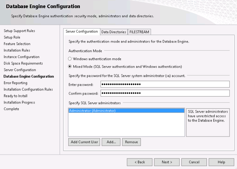

In the Database Engine Configuration window, select the Server Configuration Tab and perform the following steps:
Click Next.

If you don't have a domain password policy, you can skip this section. If your domain has a password policy configured, use a password that complies with the policy. After the installation is complete, reset the sa password to AutodeskVault@26200 and uncheck the Enforce password policy check box. It is also necessary to create a SQL login account named VaultSys.

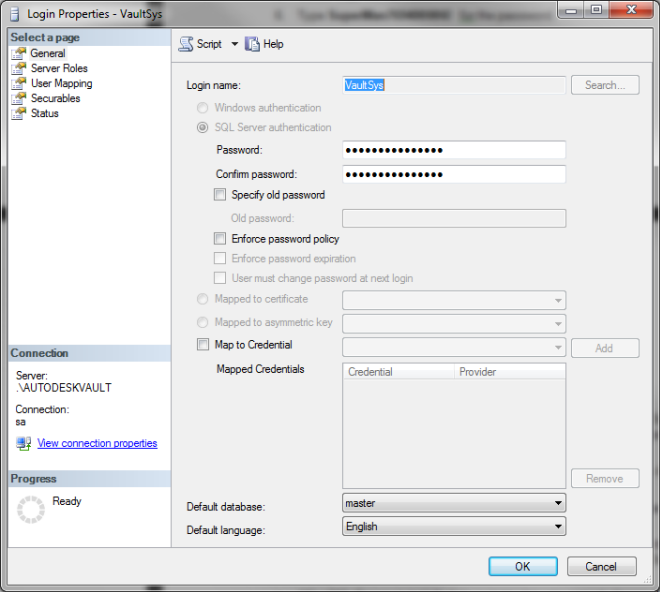

Create a SQL login account
Open the Microsoft SQL Server Management Studio.
Expand the Security -> Logins folder.
Right-click on the Logins folder and select New Login.
Type VaultSys for the login name.
Select SQL Server Authentication.
Type SuperMan769400006! as the password.
Uncheck the box for Enforce password policy.

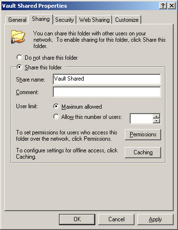

Choose a network location and create a folder.
Right-click the new folder and then select Sharing and Security.
In the Properties dialog box, click Share this folder.
Enter a name for the shared folder.
In the Comment field, enter Shared network folder for Autodesk Vault.
Click Permissions.
In the Permissions dialog box, click Add. Add the user account under which adms is running. By default, this account is a local administrator account on the adms server called Autodesk Vault.
Add the Windows account under which the SQL Server service is running. The default is Network Service.
Give both accounts Full Control.
In the Permissions dialog box, click OK.
In the Properties dialog box, click OK.
