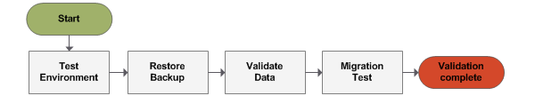

Phase 1–Validate Backup and Test Migration
Autodesk recommends that every Vault upgrade start with a validated backup.
Before You Begin
Review these essential steps for a successful migration:
Note: When you migrate between many Vault versions, you can back up without the filestore to speed up testing. This lets you validate the database migration faster.
Test Environment
The following procedure for testing the upgrade is the preferred method for validating a backup.
Perform a test upgrade of the Vault server on a machine similar to your production server. A test upgrade confirms that your backup is valid. It also reveals potential issues without affecting production.
The table below shows the benefits of matching your test environment to production:

Validate Restored Data
Verify that the filestore and databases are complete. Confirm that the restored environment works correctly. Use a client to verify the content. Use the Vault server application to verify the configuration.
Migration Test
Apply the processes in this document to the test environment. Testing provides a safe way to experience the migration process. You can discover unexpected issues without affecting production. Although testing takes time, it saves time and stress in the long run.
