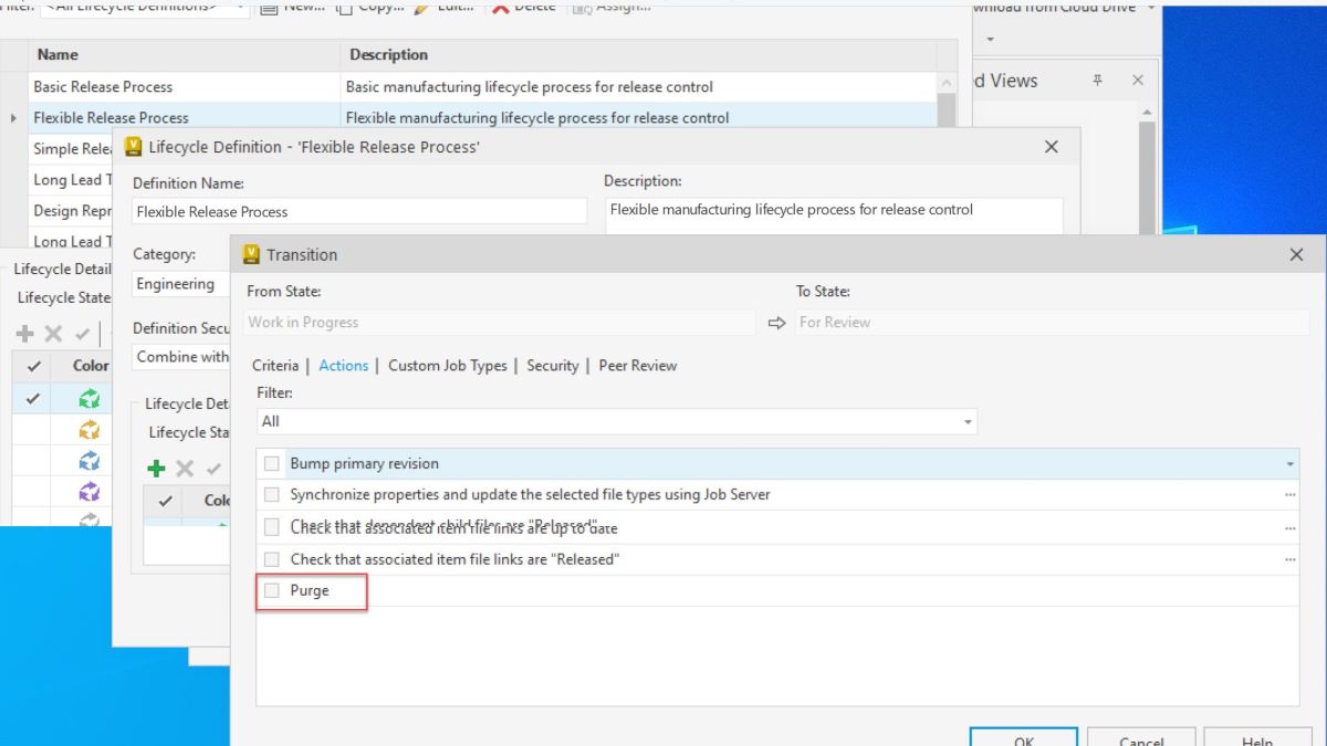

Purge on lifecycle transition
Enable Purge under Transaction actions to schedule the purging of any files, folders, or items that change during the corresponding state transition.
For more information, see Edit Lifecycle State Transition.
All selected files, folders, and items are purged using the selective purge server task in the ADMS Console.
