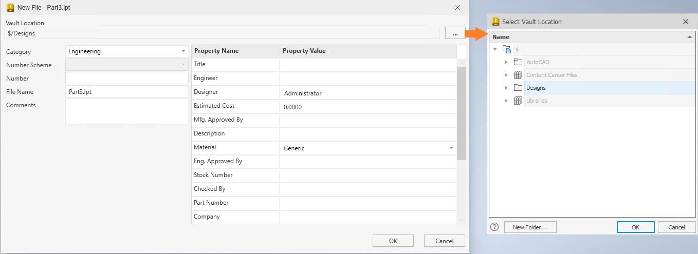

Data Standard Enhancements
Data Standard for Inventor and AutoCAD replaced the breadcrumb selection of Vault folders with a graphical Select Vault Location browser tree. Along with this enhancement, the ‘Vault Location’ field replaces the local path. The last used location is preset next time a new file is saved.
Markdown card metadata
This helps you to :
  1. Add Vault location directly as you create and save new file. You cannot save files to locked or inaccessible folders, as they are greyed out.
  2. Create new folders in Vault while doing the save action.
  3. Preset the vault location on each new file creation, as the vault location is cached.
