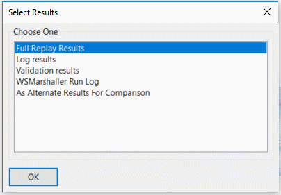

  1. Right-click the Newtown Base Control simulation (which is in the 'Network Run 1' run in the Run Group). Select Open as. You are given a list of options:
    Select Results dialog

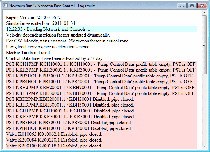

  2. Click the 'Log results' option and then OK. The text window shows a log of the actions carried out during the simulation.
    Log Results

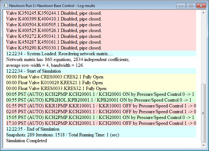

  3. Use the scroll bars to move around the report and check for any messages that indicate that there may have been a problem with the simulation. If there are any problems in the simulation, the data it produces may not be reliable.
  4. The background colour indicates the type of message:
    • Scroll to the bottom of the log. Pale green messages indicate that a pump has been switched on; pink messages are used when a pump is switched off; yellow messages indicate that a valve is open and blue messages are for general information.

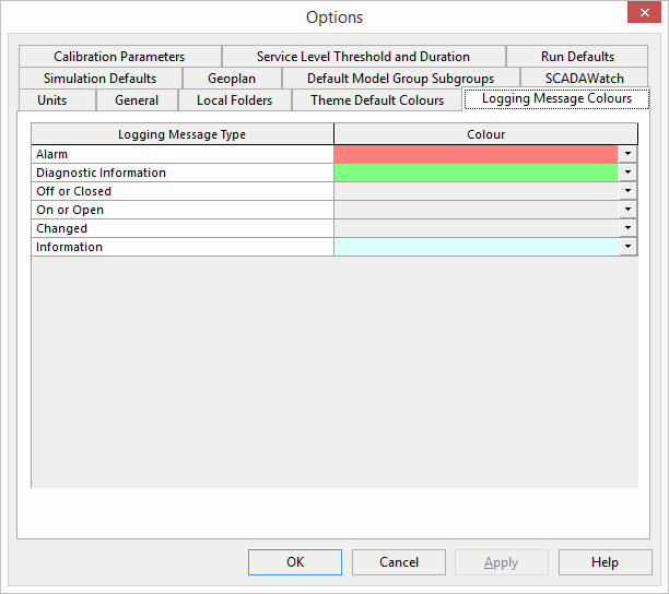

    • Select Tools Options and click the Logging Message Colours tab. This shows the colours that are used for each message type.
    • Click a colour drop-down to select a different shade from the colour palette.
    • Click OK to save the changes or Cancel to leave the colours unchanged.
