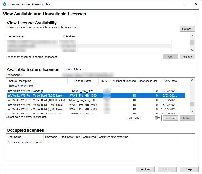

Innovyze License
Innovyze offers a subscription based license. The Innovyze license is simple to install and additional users or additional software or features can be added to the Innovyze license remotely with little user interaction. It will also be possible to easily see who is running what using the Innovyze License Administrator (ILA), an example of which is shown below:
An Innovyze license allows InfoWorks WS Pro to run on your PC or network or remotely. Innovyze provides an entitlement ID (EID), which your system administrator, or a user with similar privileges, uses to set up the license on a PC or network server using the ILA.
Note: The ILA is only used for Innovyze licenses.
