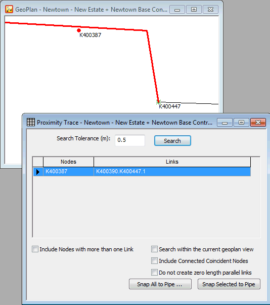

Carrying out a Proximity Trace
  1. With a network open, choose GeoPlan Tracing tools Proximity trace. This will display the Proximity Trace View. If you want to make subsequent changes to the network, it must be checked out.
  2. Set a Search Tolerance value. The default is 0.5 metres. If you want, you can carry out a trace with the default value, and then carry out further traces with higher values if needed.
  3. Select nodes to be included in the search by using the check box options:

  5. Click the Search button to list un-connected nodes that lie within the Search Tolerance distance of another pipe and match the criteria selected above.

If you select a single node on the Proximity Trace View grid, the node and adjacent pipe will be selected on the GeoPlan Window. The GeoPlan Window will zoom in to the maximum extent possible while still showing the node and the adjacent pipe. If you select more than one node, all selected nodes and adjacent pipes will be selected on the view. The GeoPlan Window will zoom in to the maximum extent possible while still showing all the nodes and their adjacent pipes.
You can select nodes by clicking the left hand column of the grid. You can zoom in further or move around on the GeoPlan Window at any time.

  1. Click the Snap All to Pipe button. The Move Node dialog will be displayed.
