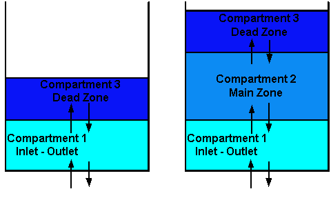

Three Compartment
The Three Compartment model assumes three independent fully mixed zones: Inlet / Outlet Zone (Compartment 1), a Main Zone (Compartment 2) and a Dead Zone (Compartment 3).
Water enters and exits the reservoir at the Inlet / Outlet zone. The order of filling of zones is:
  1. Inlet / Outlet Zone
  2. Dead Zone
  3. Main Zone
On filling, water enters the inlet-outlet compartment with any overflow first filling the third compartment or dead zone. Once this is full, any overflow from the inlet-outlet compartment moves directly to the second or main compartment. While there is water in the main compartment and dead zone, in order that the dead zone is not entirely isolated, an exchange rate is provided to allow exchange between these two compartments. On emptying, water first leaves the inlet-outlet zone and this is first replenished by water from the main compartment. Once the main compartment is empty, water is then taken from the dead zone and finally from the input-output compartment.
The parameters required to model a Reservoir using the Three Compartment Mixing Model are:
If the dead zone volume fraction is set to zero, the model reverts to the two compartment model. If the inlet-outlet volume fraction is set to zero, the result is a variation of the two-compartment model with the dead zone as the second compartment but now with an additional exchange rate between the two compartments.
Water Quality Mixing Model parameters are specified on the Reservoir Control Page of the Reservoir Property Sheet.
Three Compartment Reservoir Mixing Model
