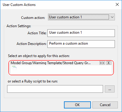

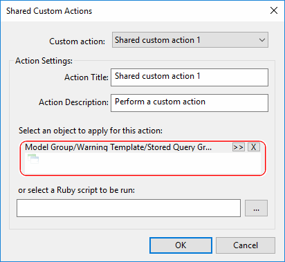

There are two implementations of the Custom Actions dialog:
User Custom Actions dialog
Option Description
Custom action Drop-down list of 10 custom actions. The numbers in parentheses do not change when the action title (see below) is changed.
Action Settings
Action Title The action title will be displayed in the Custom action drop-down, in the actions menu and in the tooltips for the Shared Actions toolbar and the User Actions toolbar.
Action Description The action description will be displayed in the status bar when hovering over the action menu items or toolbar buttons.
Select an object to apply for this action
Used to select a database tree object to be applied to the GeoPlan when the custom action is selected.
Note: Either a tree object or an external Ruby script file may be selected. It is not possible to select both.
or select a Ruby script to be run
Used to browse for an external Ruby script file to be run when the custom action is selected.
