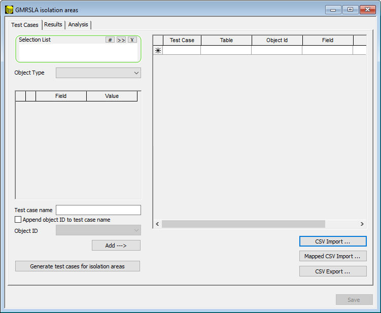

Generate test case for isolation area
Allows you to use isolation areas in GMR.
For each isolation area code found in the Selection Links to be included in analysis, all links in the isolation area will be closed and a simulation run. There will be one simulation run per isolation area.

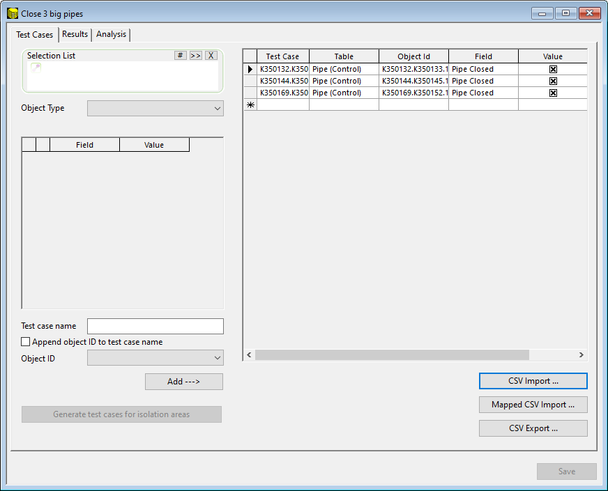

CSV Import Click this button to import a .csv file containing test case information previously set up.
Mapped CSV Import Click to open the GMR Mapped CSV Import dialog, which is used to set up test cases based on components from a CSV file or SQL results grid. These test cases are transferred to the test case grid, described above.
CSV Export Click this button to create a .csv file containing the current test case configuration.

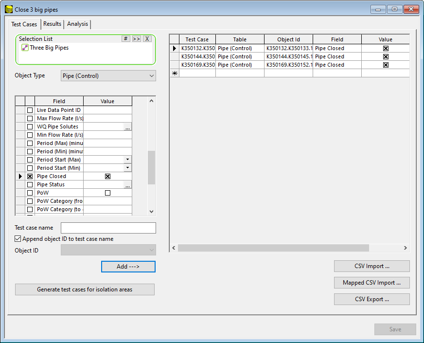

Generalised Multi Run (GMR) is setup by specifying test cases. The following image shows a very simple case. There are three test cases and so there will be three runs. Each run involves closing a single pipe, and the run takes the name of the pipe.
To make this simple list of test cases, use the “wizard” section on the left pane of the dialog.
  1. Start with a selection list of three pipes. Drop this into the drop target.
  2. From the drop-down menu, select Pipe (Control). This exposes the fields for the pipe control fields.
  3. Find Pipe Closed and check the box (i.e., closed).
  4. Check the box Append Object ID to Test Case Name. Leave the Test Case Name blank.
  5. Click Add - - > . Three test cases are created. Each takes the name of its pipe, and each test case involves closing the pipe.

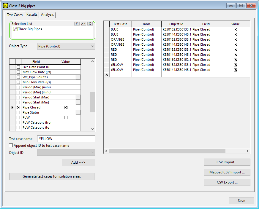

To add multiple objects in one test case:
  4. Set the test case name to RED.
  5. Click Add - - >.
A single test case is created. The GMR would run single simulation called RED, in which three pipes are closed.
  1. Repeat the steps above but with the name YELLOW.
  2. Click Add - - >.
  3. Delete one of the rows of the YELLOW test case
Now the GMR has two simulations called RED and YELLOW with three and two closures, respectively. Continue in this way to make two further test cases called ORANGE and BLUE.

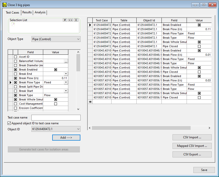

For the set-up of a more complex GMR. Take the three pipes, and for each pipe, set up a burst. The burst involves setting several Control fields. But go beyond this and set up three different burst sizes.
  3. Set the burst fields: enable the burst; for the entire simulation; a flow type burst; a fixed flow; a flow value of 0.5 l/s. So, there are five Control fields.
  4. For test case, give the name SmallLeak and check the box Append Object ID to Test Case Name.
  5. Click Add - - >.
  6. Modify the leak value to 1.0 l/s and change the name to MediumLeak. Click Add - ->.
In this way you have multiple tests cases for each object. And each test case involves the setting of multiple fields.
