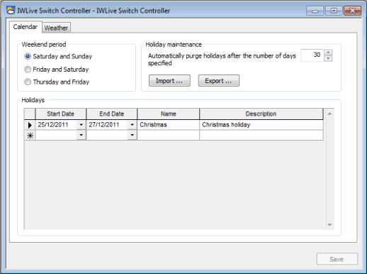

Calendar Page
The calendar page is used to customise calendar information by defining weekend days and holidays.
Show image
Weekend period
Select an option to define which days of the week comprise a weekend (Saturday and Sunday by default).
Holiday maintenance
The Holiday maintenance section contains housekeeping and import / export options:
  • Automatically purge holidays after the number of days specified - the number of days after a holiday period has passed when the calendar entry will be removed from the database.
  • Import button - import holiday data from a specified .csv file to the Holidays grid. The option to overwrite existing holiday information or append data to the grid will be given.
  • Export button - export information from the holidays grid to a .csv file
The .csv format for import / export is shown below:
BegYear,
BegMon,
BegDay,
EndYear,
EndMon,
EndDay,
Name,
Desc
2011,
12,
25,
2011,
12,
27,
Christmas,
Christmas holiday
Holidays grid
The Holidays grid is used to define holiday periods of a day or more:
  • Start Date - indicates beginning of holiday period
  • End Date - indicates end of holiday period
  • Name - name of holiday (optional)
  • Description - further information about holiday (optional)
Right click in grid to display a context menu allowing cut, copy, paste and sorting of rows.
Right click left hand side of row to display a context menu allowing insertion and deletion of rows.

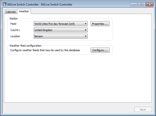

Weather Page
All fields on the weather page must be defined.
Show image
Weather Feed
List of weather feeds currently enabled for selection by the Weather Feed Configuration dialog.
Country
List of countries supported by the selected weather feed
Location
List of cities and other locations supported by the selected weather feed
Properties
Click the Properties button to set the connection properties of the currently selected weather feed.
The Weather Feed Properties dialog will be displayed.
Configure
Click the Configure button to select one or more weather feeds for use with the database. The Weather Feed Configuration dialog will be displayed.
