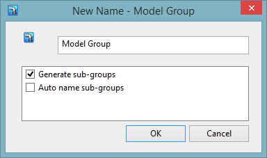

New Name - Model Group dialog
New Name dialog
The New Name dialog is used when creating a group or database item.
The dialog is typically opened by right-clicking the database or a model group name in the Model Group window or Explorer window, then choosing New, then choosing one of the listed items.
Typical appearance:

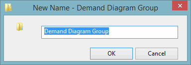

New Name - Demand Diagram Group dialog
Example with options:
Item Description
Name box This is the suggested name for the new group or database item. You can change it in this box if you want to.

Model groups
Generate subgroups If ticked, generates the default set of subgroups within a model group.
Auto name subgroups Shown only if the Generate subgroups box is ticked. If ticked, automatically names the default subgroups. If this box is not ticked, you will be prompted to name each subgroup before it is created.
