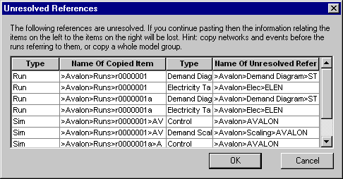

Unresolved References dialog
This dialog is displayed if you attempt to copy data that refers to items that do not yet exist in the destination database. The dialog lists the items for which there are unresolved references, giving their names and the names of the missing referenced items.
If you click OK, the reference data will be lost. You can avoid this situation by copying entire model groups or by copying items in the appropriate order.
If you click Cancel, no data will be copied (regardless of whether it is included in the list or not).
