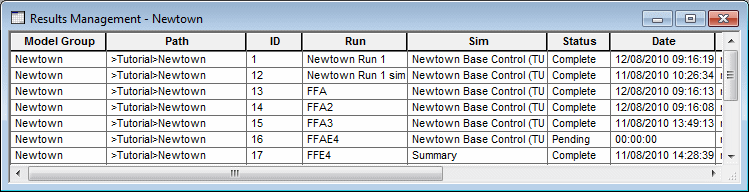

Results Management view
This view allows management of results data stored in the database.
The view displays a grid view of simulations in the database or in a particular run group or model group. The grid describes the simulations, and what results are currently stored. The grid can be used to re-run selected simulations, move results, remove unwanted results, or view further information. For more details on using the view, see Managing results.

The Results Management grid contains the following columns:
Model Group: The name of the Model Group within which the simulations were carried out.
Path: Path of the Model Group within which the simulations were carried out
ID: The internal database identifier for this simulation.
Run: The name of the run within which the simulations were carried out.
Sim: The name of the simulation.
Status: The current simulation status: Pending, Complete or Failed.
Date: The date and time when the simulation was carried out.
User: The user who carried out the simulation.
Location: The location where results are stored:
  • Local Machine: results are stored in the working folder
  • Server: results are stored in the remote results root
Machine: Name of the machine of the user who carried out the simulation.
Size: Size of the results file.
Log File: Indicates whether a log file is stored in the database.
