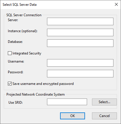

This dialog is used when :
- importing data from an SQL Server database via the Open Data Import Centre.
- exporting data to an SQL Server database via the Open Data Export Centre.
- updating the network and control from an SQL Server database using model builder. The data needs to be in a pre-defined schema in SQL Server.
The dialog is displayed when:
- Browsing for a file in the above centres with SQL Server selected as the source or export type.
- Selecting Connect to SQL Server in the Model Builder dialog.
It provides connection options for the Microsoft OLE DB Driver for SQL server, which connects to a Microsoft SQL Server database.
Item
Description
| SQL Server Connection
Server
The name of the server
Instance (optional)
Instance name if required (for example, myserver/sqlexpress)
Database
The name of the database
| Integrated Security
If checked, authenticates connection to SQL Server by the current Windows account name and password.
| Username
Username required for integrated security.
| Password
Password required for integrated security.
| Save username and encrypted password
If checked, stores the username and password entered in the boxes above.
| Projected Network Coordinate System
Use SRID
Enabled when connection details have been entered.
Opens the Select A Projected SRID dialog.
