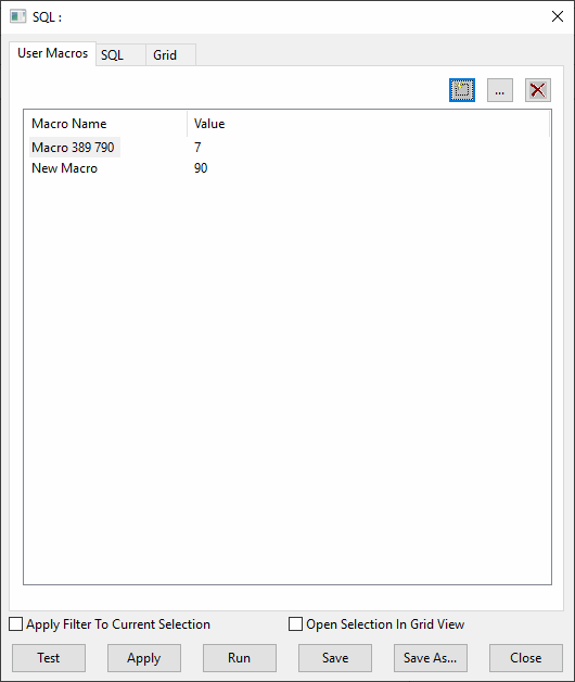

This page on the SQL dialog lets you create variables for representing values within the query. These variables are called macros.
The page is opened by clicking the User Macros tab on the SQL dialog.
User Macros page
Item Description
Toolbar
New macro
New macro
Opens the SQL Macro dialog, for creating a new user macro.
Edit macro
Edit macro
Opens the SQL Macro dialog for the highlighted macro, so that the macro can be edited.
Tip: Double-clicking a name in the Macro Name column has the same effect.
Delete macro
Delete macro
Deletes the highlighted user macro.
Macro list
Macro Name (column) Lists the user macros created using the SQL Macro dialog.
Value (column) Lists the values corresponding to the user macros in the Macro Name column. The values are set in the SQL Macro dialog.
