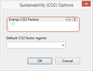

The Sustainability Options dialog is used to set sustainability calculation options when the Sustainability (CO2) option is checked in the Schedule Hydraulic Run View.
Show image
| Option | Description |
Energy CO2 Factors |
Energy CO2 Factors Data item. |
Default CO2 factor regime |
Select a CO2 factor regime present in the Energy CO2 Factors Data item above. This regime will be used to calculate network energy losses as a CO2 equivalent and as a default for any pumping station that does not already have a regime specified. |
