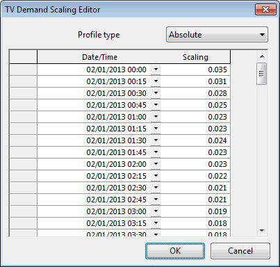

The TV Demand Scaling Editor is used for viewing and editing time-varying profiles.
This dialog is displayed when the
button is clicked for an area on the Edit Profile column of the Time Varying Demand Scaling page of the Demand Scaling Editor.
Show image
Available profile types are 24 Hour, 7 Day and Absolute.
Please note that when using time varying profiles in the context of DemandWatch / IWLive Pro Operator Client integration, the default profile type is Absolute.

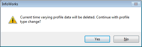

A message similar to the one below will be displayed to users when switching between profile types:
Click Yes to continue (a blank profile will be displayed, ready for editing) or No to abort (the current profile will be kept).
