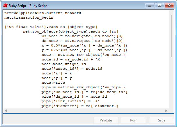

The Ruby script editor allows you to view and edit the Ruby scripts in your Ruby script group.
This editor also allows you to validate the syntax of the Ruby script, and run it to the current network.
To display this editor, double-click a Ruby script in the Ruby script Group in the tree. Alternatively, you can drag-and-drop a Ruby script in the background.
| Item | Description |
| Validate | Validates the syntax of the Ruby script. |
| Run | Runs the Ruby script to the current network. |
| Save | Saves the changes to the tree. |
