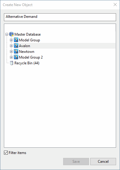

Create New Object dialog
This dialog is used to choose the name and location for a newly created object.
The dialog is displayed from various places, including when you click Copy on the Commit History dialog.
Item Description
Object name box You can enter a name for the object here, or amend the suggested name. The name must be unique within a model group.
Database tree You can use this to select a location for the new object.
Filter items If ticked, shows only items of the correct type in the database tree.
Save Saves the object. If this is not available, check that the object name is unique within the model group chosen in the database tree.
