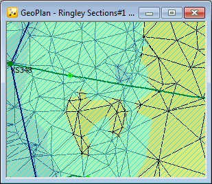

You can display the outlines of the underlying triangles that make up a TIN ground model.
TIN Triangles Displayed on the GeoPlan

To display TIN triangles:
- display the ground model as a theme if it is not already displayed
- right click the GeoPlan Window and choose
Properties from the context menu. This displays the
GeoPlan Properties dialog. This dialog may already be open if you are setting the parameters to display the ground model as a theme at the same time
- switch to the
General Page.
- check the
Show Triangles in TIN Ground Models box to display the triangles
