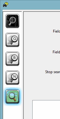

  1. Click the Find network objects button on the Operations toolbar.
    This will display the Find Network Objects dialog.
  2. Select GIS Find in the left panel.
