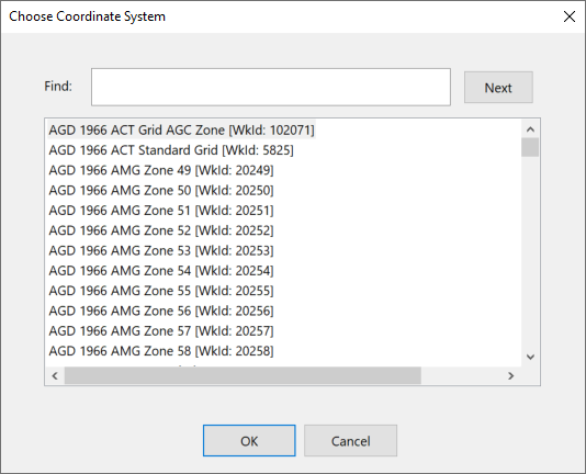

Choose Coordinate System dialog
This dialog is used to:
The Choose Coordinate System dialog for ArcGIS Maps includes a list of projected coordinate system compatible with InfoWorks programs and ArcGIS.
Change the projection system for a shape file layer
  1. Select the layer of interest in the GIS Layer Control dialog.
  2. Click Ellipsis button located adjacent to the Projection box. The Choose Coordinate System dialog is displayed.
  3. Select the desired projection system and click OK.

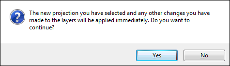

  4. The following warning message may be displayed to let you know that changes will be applied immediately :
  5. Warning message
  6. Click Yes to continue. The new selected coordinate system is applied to the layer and appears in the Projection box.
  7. Or click No to abort and close the dialog. The projection system has not been changed for the layer.
