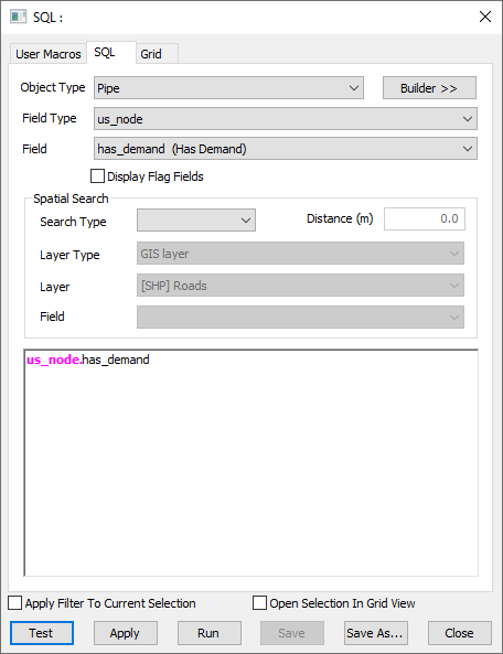

Example 1
SQL query context: Object type: Pipe
us_node.has_demand
selects all pipes that have at least one upstream node with demand.

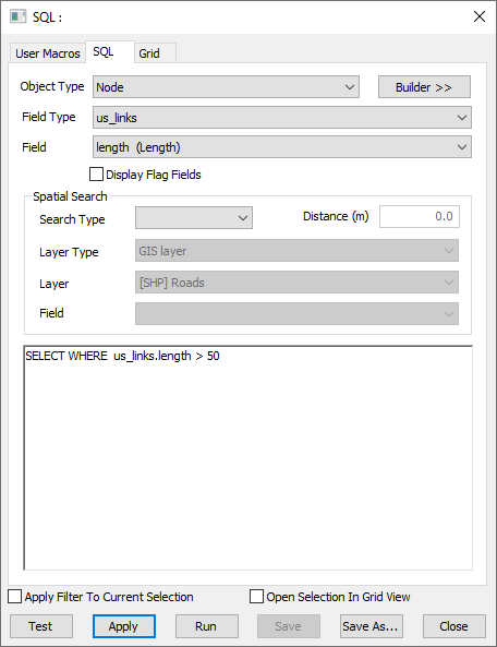

Example 2
SQL query context: Object type: Node
SELECT
 WHERE us_links.length > 50
selects all nodes that have at least one upstream link with a length greater than 50.

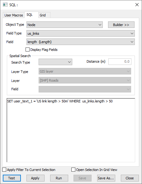

Example 3
SET
  user_text_1 = 'US link length > 50m'
sets user_text_1 to "US link length > 50m" on all nodes that have at least one upstream link with a length greater than 50.
