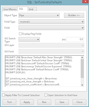

Turbidity values can be set for multiple links using SQL. See example
The example SQL below will display a prompt dialog in which values for each turbidity parameter can be specified. Enter the turbidity parameter values and click OK to apply the values to all links with associated control.
PROMPT LINE $maxshear 'Default Max Shear Strength' STRING; PROMPT LINE $intshear 'Default Initial Shear Strength' STRING; PROMPT LINE $erosioncoeff 'Default Erosion Coeff' STRING; PROMPT LINE $erosionexp 'Default Erosion Exponent' STRING; PROMPT LINE $releasecoeff 'Default Release Coeff' STRING; PROMPT DISPLAY; SET joined.wq_max_shear_strength = $maxshear; SET joined.wq_init_shear_strength = $intshear; SET joined.wq_erosion_coefficient = $erosioncoeff; SET joined.wq_erosion_exponent = $erosionexp; SET joined.wq_release_coefficient = $releasecoeff; |
