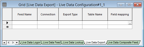

This view is used to configure the export in
IWLive Pro Operator Client of simulation results,
PressureWatch and QualWatch results to external databases.
Note: This functionality does not support export to PI, iHistorian or ClearSCADA databases.
The view is displayed by double-clicking a live data configuration object in the Model Group window, then selecting the Live Data Export tab.
| Item
Description
| Left-most column
If clicked, selects the whole row.
A forward triangle indicates the current row.
An asterisk indicates where a new object can be created by entering its details (in this case, by entering a feed name).
| Fields
| Feed Name
User name for the export feed.
| Connection
Dropdown list of connections from the
Live Data Logon view.
Export Type
Dropdown list of export types. The type of results to be exported.
| Watch results
PressureWatch or QualWatch results.
| Schedule
Pump schedules optimised
These four result types require the use of an
export style object where export settings can be set.
| Time-varying results
Time varying simulation results (settings available on the TVD page of the Export Style dialog).
| Summary results
Summary simulation results (settings available on the Summary page of the Export Style dialog).
| Warning summary results
Warning summary simulation results (settings available on the Warning page of the Export Style dialog).
| Warning detail results
Table Name
Dropdown list of available table names in the database.
Destination for the export.
| Field mapping
Clicking the browse button
opens the the Live Data Export Field Mapping dialog where internal fields (InfoWorks WS Pro database) are associated with external fields (the database the results are to be exported to).
| Main context menu options
| Copy
Copies the value(s) of the selected cell(s) to the clipboard. Several cells can be selected in the same row.
| Field mapping
Opens the Live Data Export Field Mapping dialog, where internal fields (InfoWorks WS Pro database) are associated with external fields (the database the results are to be exported to).
Note: Only mapped fields will be exported.
| Properties
Displays the Live Data Export
Object Properties window showing the properties for a single live data.
