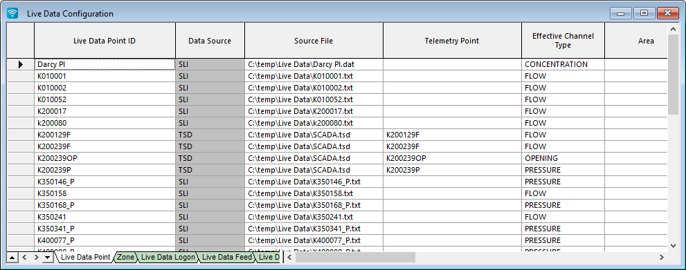

| Change the live data file
Applicable only to live data points.
Allows a live data file entry in the Live Data Point view to be replaced with a different entry.
Convert to absolute filenames
Convert to relative filenames
Allow conversion of filenames in the Source File field.
Absolute pathnames are the full path to the file, including the drive letter.
Relative pathnames are relative to the database location.
| Rebase filenames
Allows adjustment of filenames in the Source File field, used for example if files have been moved to a different location on your computer. See
Live Data Rebase Filenames dialog for more details.
