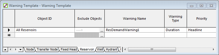

Use the Warning Template Grid window to edit and view the data that defines the occurrence of an event within the network.
See Warning Templates for further details.
| Field | Description |
| Object ID |
Drop-down list containing the IDs of objects of the appropriate type in the current network. There is also an option to use all objects of that type (e.g. All Nodes, All Pump Stations). |
| Exclude Objects |
Initially empty, this field allows users to specify a selection list of objects to exclude from the selected warning template (optional). It remains blank if no objects are excluded and will be populated with the name of the excluded objects otherwise. The screenshot above illustrates the case of the ResDemandWarning1 warning template from which some reservoirs have been excluded. Click the
Note: The Exclude Objects field will be disabled (grayed out) if an option other than
All Objects is selected for Object ID.
| Warning Name | User specified name for the warning. |
| Warning Type |
Drop-down list of available warning types:
Tip: The first two warnings apply to simulations (simulation warnings) whereas the bottom four warnings relate to the automatic verification process (verification warnings). Refer to the
IWLive Pro Operator Client help for more information.
| Priority |
Drop-down list of available priority values:
The colour scheme for priorities can be viewed and edited in the Warning Themes tab of the GeoPlan Themes dialog. |
| Results Field | Drop-down list containing results fields appropriate to the object type. This list is populated if the current network has simulation results loaded. |
| Test Criterion | Drop-down list of available test criteria: <, <=, =, >=, > |
| Critical Value |
Numerical value specified by user. The threshold value that is used to trigger an event. |
| Enable |
Check this option to enable the warning for use in IWLive Pro Operator Client. |
| Permitted Gap |
Enabled when Warning Type is set to Duration. If the amount of time between threshold warnings is less than the Permitted Gap specified, the event will be considered to be continuous. |
| Minimum Duration |
Enabled when Warning Type is set to Duration. The minimum amount of time that test criterion must be met before the occurrence is considered to be an event. |
