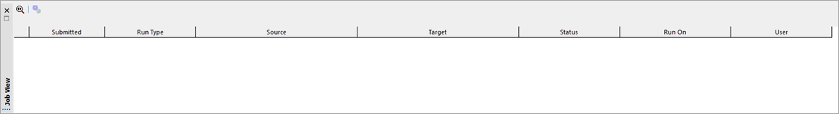

The Job View window shows the progress of the individual jobs within a run. All runs consist of multiple jobs: the normal run has three jobs including the hydraulic simulation. Runs with coarse grained parallelism have many jobs and it can be useful to observe their progress and use of cores.
Advanced view
Display additional columns in the Job View window. |
Opens the Job Progress window, which displays messages from the hydraulic simulation. |
| Submitted | The time and date that the run was submitted. |
Run type |
The type of the run that has been submitted. |
Source |
The source of data that will be used as input for the run. |
Target |
The target data that will receive the output from the run. |
Status |
The current status of the run. A run passes through a range of states between submission and completion. Each state is associated with a colour that is used to colour the entire row:
Completed runs (in green) and terminated runs (in red) are held in a schedule as "recent history". You can clear this recent history as described above. |
Run On |
The name of the computer or agent group that the run is scheduled to run on. If this is an agent group or 'Any computer', then once the run has started, the name of the computer is appended in brackets. |
User |
The name of the user who submitted the run. |
