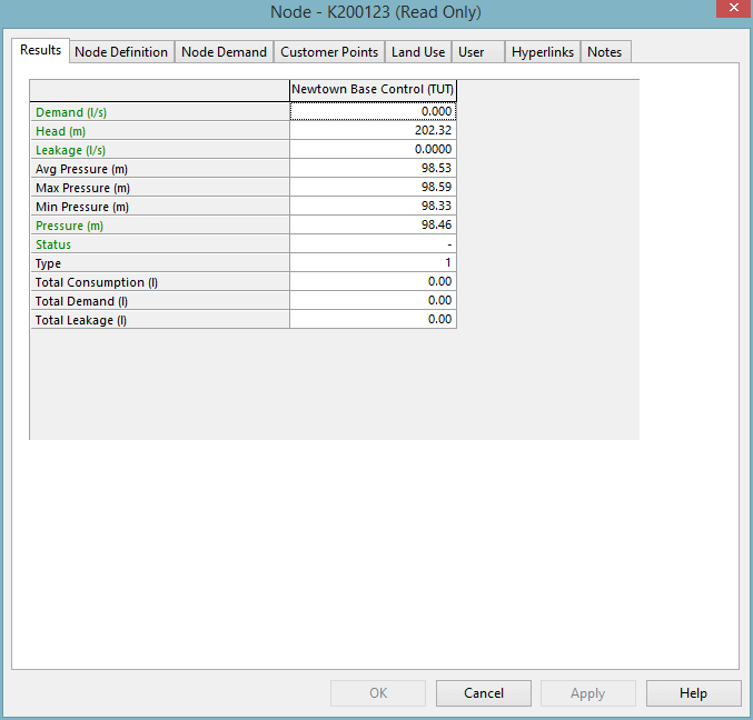

This page displays the results for this network object for the current simulation timestep.
The page will only be displayed if you open the property sheet from a simulation opened for replay, and not from a network open for viewing or editing.
If there are two sets of results loaded on the same GeoPlan, the page will contain results for both simulations.
To load a second simulation into the same GeoPlan as the first:
Alternatively, hold down Ctrl and drag the second set of simulation results onto the same GeoPlan as the first set of results.
The data fields displayed on the property sheet vary depending on the type of object displayed on the property sheet. For more details on the results, see Network data field information.
