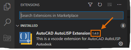

  1. In Visual Studio Code, click File menu > Preferences > Extensions.
  2. In the Extensions view, clear any text from the Search box.
  3. Under the INSTALLED section, locate AutoCAD AutoLISP Extension in the list.
    The version number of the extension will be next to its name.

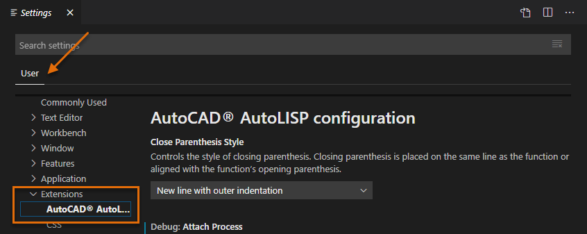

  1. In Visual Studio Code, click File menu > Preferences > Settings.
  2. On the User tab, expand Extensions and click AutoCAD AutoLISP Configuration.

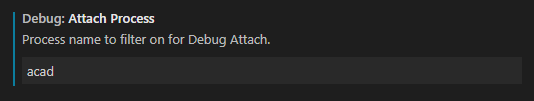

  3. In the Debug: Attach Process text box, enter one of the following values in bold:
    • (Windows) acad
    • (Mac OS) AutoCAD
    Note: The process name is case sensitive, so acad or AutoCAD isn’t the same as ACAD or autocad.

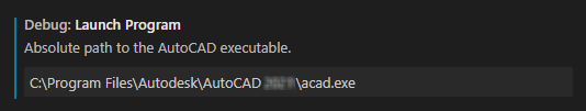

  4. In the Debug: Launch Program text box, enter the absolute path to the AutoCAD executable.
    The absolute path varies based on the release and platform on which AutoCAD was installed.
    • (Windows) "C:\Program Files\Autodesk\AutoCAD 2026\acad.exe"
    • (Mac OS) "/Applications/Autodesk/AutoCAD 2026/AutoCAD 2026.app/Contents/MacOS/AutoCAD"
  5. Optionally, in the Debug: Launch Parameter text box, specify any command line switches during the launch of the AutoCAD application.

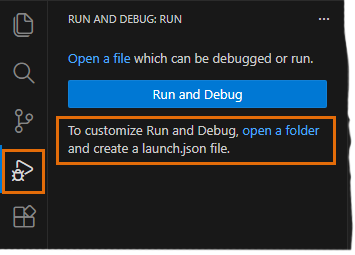

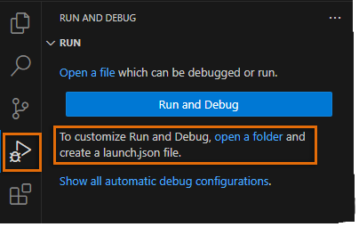

Note: A folder must be opened before debug configurations can be added, and debug configurations should not be added to a workspace but to a folder only. See To Open a Folder for steps on opening a folder.

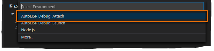

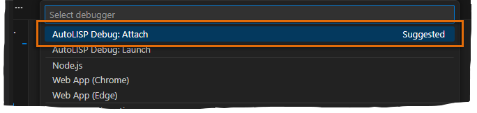

  1. In Visual Studio Code, on the Activity Bar, click Debug and then click Create a launch.json File (or click Debug menu > Open Configurations).
  2. On the Configurations menu, choose AutoLISP Debug: Attach.
    A new file named launch.json that contains the AutoLISP Debug: Attach configuration should now be open in the current editor window.

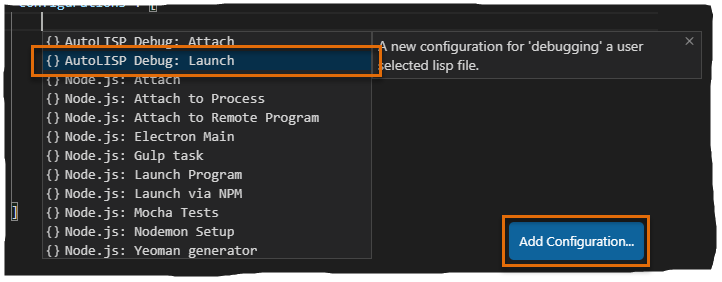

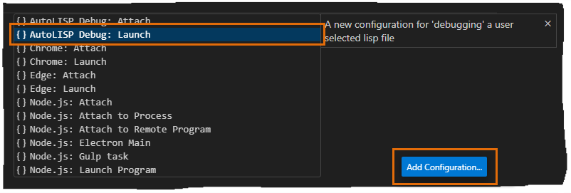

  3. In the editor window, lower-right corner, click Add Configuration and then choose AutoLISP Debug: Launch from the list that is displayed.
