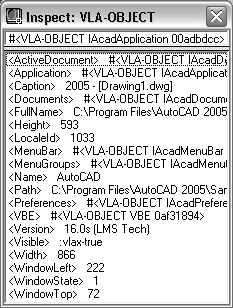

In addition to using the Inspect window to view the current value of a variable, you can use it to view the current property values of an object.
(vlax-dump-object (vlax-get-acad-object)) ; IAcadApplication: An instance of the AutoCAD application ; Property values: ; ActiveDocument = #<VLA-OBJECT IAcadDocument 000002569b4802d8> ; Application (RO) = #<VLA-OBJECT IAcadApplication 00007ff78ec15be0> ; Caption (RO) = "Autodesk AutoCAD 2025 - [Drawing1.dwg]" ; Documents (RO) = #<VLA-OBJECT IAcadDocuments 00000256aab93c70> ; FullName (RO) = "C:\\Program Files\\Autodesk\\AutoCAD 2025\\acad.exe" ; Height = 1040 ; HWND (RO) = 595288 ; LocaleId (RO) = 1033 ; MenuBar (RO) = #<VLA-OBJECT IAcadMenuBar 00000256aab94248> ; MenuGroups (RO) = #<VLA-OBJECT IAcadMenuGroups 00000256fcb1fea8> ; Name (RO) = "AutoCAD" ; Path (RO) = "C:\\Program Files\\Autodesk\\AutoCAD 2025" ; Preferences (RO) = #<VLA-OBJECT IAcadPreferences 00000256aac5b2e8> ; Initializing VBA System...StatusId (RO) = ...Indexed contents not shown... ; VBE (RO) = #<VLA-OBJECT VBE 00000256ce7ac5f8> ; Version (RO) = "25.0s (LMS Tech)" ; Visible = -1 ; Width = 1916 ; WindowLeft = 2 ; WindowState = 1 ; WindowTop = 0 T
Inspect.
