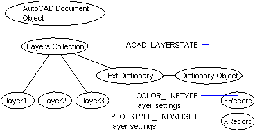

AutoCAD saves layer setting information in an extension dictionary of the LayerTable object. When you first save a layer state, AutoCAD does the following:
Each time you save another layer setting in the drawing, AutoCAD creates another XRecord object describing the saved settings and stores the XRecord in the ACAD_LAYERSTATE dictionary. The following diagram illustrates the process.
You do not need (and should not try) to directly manipulate the entries when working with layer states. Use the functions of the LayerStateManager object to access the dictionary. Once you have a reference to the dictionary, you can step through each of the entries which are represented as DBDictionaryEntry objects.
