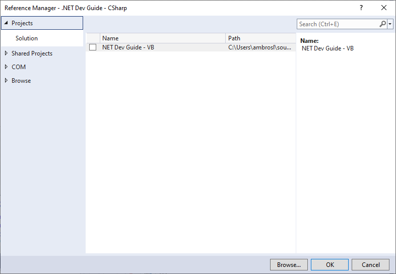

When you add a project to a solution, a new node for the project is displayed in the Solution Explorer. This node is titled the same as the project that was referenced. After a project is added, it must be referenced to the project using the Add Reference dialog box.
If the project has been compiled into an assembly DLL file, you can reference the file to a project using the Add Reference dialog box. After a project or assembly DLL file is referenced to a project, you use the Imports or using declaration with the namespace or project name to utilize any of the exposed objects (classes or forms) in your project.
To reference another project
The selected project will appear under the References folder in the Solution Explorer.
